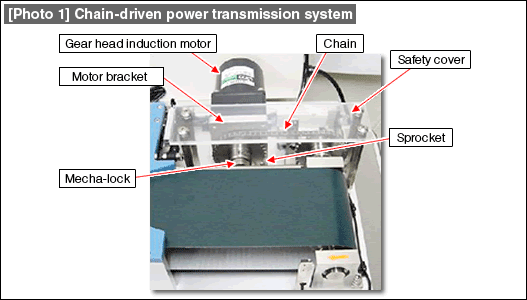

A transfer conveyor belt is usually driven at a low constant speed. Accordingly, a gear head induction motor with a reduction ratio of 60:1 is selected here as a driving power source. To transmit this driving power efficiently to the flat belt pulley for driving the conveyor belt, a chain-driven power transmission system (Photo 1) is applied here:
![[Photo 1] Chain-driven power transmission system [Photo 1] Chain-driven power transmission system](http://www.misumi-techcentral.com/tt/en/lca/images/091_01.gif)

Explanation of the load calculation method is omitted here because of the low speed and not-heavy transmission load on a sprocket chain. The number of sprocket-teeth and the number of chain links can be determined according to the procedure below. A safety cover over the chain is required.
- Determine the distance between the motor shaft and the flat belt driving pulley shaft.
- Determine the ratio of the number of teeth on the two sprockets (speed ratio).
- Determine the number of teeth on the smaller sprocket.
. - Determine the number of teeth on the larger sprocket from the speed ratio.
- Select a product series from the sprocket chain catalog.
- Use the formula below to calculate the number of chain links corresponding to the chain length
. - Round up the calculated value to the nearest integer to determine the number of chain links. After drilling long holes for base fixing in the motor mounting bracket, adjust chain tension during assembly.
