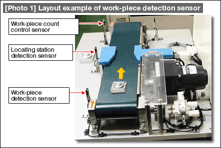

Positioning pushers are needed with transfer conveyors in order to align and position work-pieces. Especially when the following process utilizes any automation, they are required.
- Out-feeding of work-pieces by Pick & Place units.
- Automated work-piece inspection with image processing systems.
- Processes requiring accurate work-piece positions such as automated soldering stations and resin dispensers.
(1) Focus points of positioning pusher material selections
The mechanism example uses an air cylinder (Pico-Table MPPT16-20-RS) to push and align the position of work-pieces on the conveyor.
