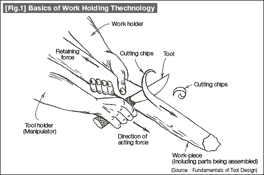

(1) The basics of work holding
- Work holding technology is needed for all fixturing, automated assembly, and processing.
- Mechanisms to hold work-pieces by some means (retaining, gripping, chucking) are called "Work Holders".
- There are mechanical, electrical, air, hydraulic means to hold the work-pieces.
- The operational relationship between the work holders and the process tools (manipulators) is the same whether the process is for cutting or assembly.
- The shaping and assembly process are performed by applying desired movements of the tooling on the work-pieces held by work holders.
![[Fig.1] Basics of Work Holding Thechnology [Fig.1] Basics of Work Holding Thechnology](http://www.misumi-techcentral.com/tt/en/lca/images/097_01.gif)

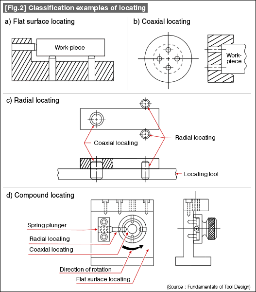

(3) Classification of Locating
Locating can be classified into the following four types (see [Fig.2])
- Flat surface locating
- Coaxial locating
- Radial locating
- Compound locating
![[Fig.2] Classification examples of locating [Fig.2] Classification examples of locating](http://www.misumi-techcentral.com/tt/en/lca/images/097_02.gif)
