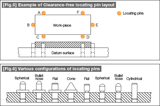

- For applications where the work-pieces can move due to external forces, the pin shape [fig.5] must be considered and number of pins used will need to be increased to prevent the movements. [Fig.6] although it is only possible to extract the work-piece upwards, secure holding is possible with this method.

![[Fig.5] Example of Clearance-free locating pin layout, [Fig.6] Various configurations of locating pins [Fig.5] Example of Clearance-free locating pin layout, [Fig.6] Various configurations of locating pins](http://www.misumi-techcentral.com/tt/en/lca/images/098_05.gif)
