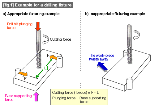

When locating work-pieces that receive external forces, location datum surfaces must be provided in locations to take account for such forces. Errors in datum location provisions will result is the following problems.
Problems caused by datum location provision errors
- Instability in locating accuracies.
- Work-piece damage troubles.
- Accidents due to damaged work-pieces and tools.
Therefore, locating of work-pieces with applicable external forces must take in consideration the sizes and the directions of the allocable forces.
Locating methods for work-pieces with applicable external forces
- Identify all forces that apply.
- Understand the amounts and directions of the forces.
- Design appropriate datum features that can withstand all the forces.
Example
Case of drilling fixtures
In case of [Fig.1], there are two forces that apply.
- Rotation force of the drill bit (Torque)
- Plunging force of the drill bit (Thrust)
[Fig.1-a shows a datum structure that can withstand these two forces. [Fig.1-b] shows an example with different locating pin layout, and it can be seen that the work-piece cannot be securely located against the torque.
