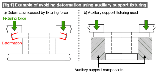

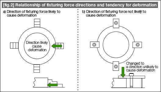

(3) Locating methods to avoid deformation
The basic of locating methods in avoiding deformation is to consider a locating feature with the following points in mind.
- Consider the deformation strength of the part section where holding forces are applied.
 - If possible deformation is anticipated, use auxiliary support components when applying the holding force.
 - Choose directions of forces that hardly cause deformations when applying the holding forces.
 - Choose part locations where deformation will not result.
![[Fig.1] Example of avoiding deformation using auxiliary support fixturing [Fig.1] Example of avoiding deformation using auxiliary support fixturing](http://www.misumi-techcentral.com/tt/en/lca/images/101_01.gif)
![[Fig.2] Relationship of fixturing force directions and tendency for deformation [Fig.2] Relationship of fixturing force directions and tendency for deformation](http://www.misumi-techcentral.com/tt/en/lca/images/101_02.gif)
Here, a fixturing method to avoid deformations was explained. However, in a strict sense, the examples [Fig.1] and [Fig.2] are fixturing conditions where some metal elastic deformation within tolerable ranges are allowed.
