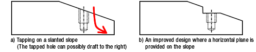

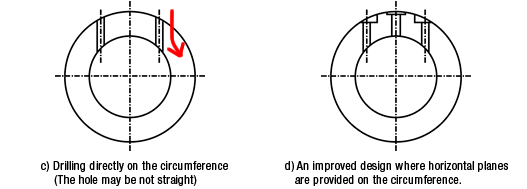

- For drilling, the metal is cut by a rotating bit with push forces and rotational speeds.
- When drilling, the tip of the drill (Name: chisel edge) is rotating at zero speed since the center of the point has no radius.
- The function of this chisel edge is to dig into the metal to be cut and create a priming point.
- When the drill is pushed against the metal to be cut, the chisel edge can cut into the metal perpendicularly.
- However when the drill is not perpendicular, the chisel edge does not bite the metal correctly and the hole machining will not be straight.
- Therefore, the drilling surface should be designed to be perpendicular to the drill axis.
[Example-1] Machining a tapped hole on a slope
[Example-2] A case of hole machining on a circumference of a circle
