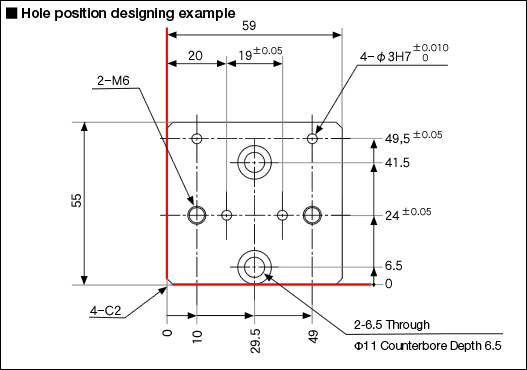

b) Easy machine assembly datum designs
- Utilize the inherent accuracy of the machine tools for parts accuracy.
- Use the external profile (or datum reference holes) features as the datum surfaces, and measure from these surfaces to machine the assembly datum features. (2 red lines show in Fig. are the datum lines)
- Therefore, an easy to machine design is where all the datum locations can be machined at once while the part is mounted on a machining fixture.
- If a fixtured part must be unfixtured and reset (ex. reversing), resetting error will result.
Highly accurate and cost effective part designs are where the parts' all datum features can be machined at once with one time fixturing.
