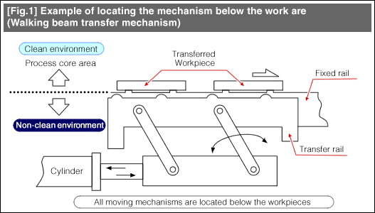

(1) Do not bring in contamination.
| ■Example | ||
| a) | Drive mechanisms will generate particulates and lubrication scattering. These contaminants are relatively heavy and will fall by gravity. In order to obtain clean process cores, position the drive mechanisms below the process cores. (In case of Walking beam mechanisms and etc. (see [Fig.1]) | |

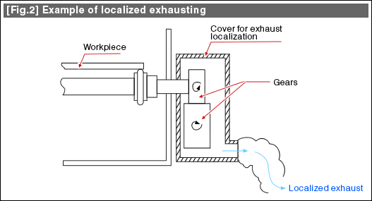

| b) | In case of Pressurized turbulence type of simplified clean designs, provide exhausts near the contamination generating mechanisms ([Photo 1]), or cover the entire mechanism and provide a localized exhaust ([Fig.2]). |

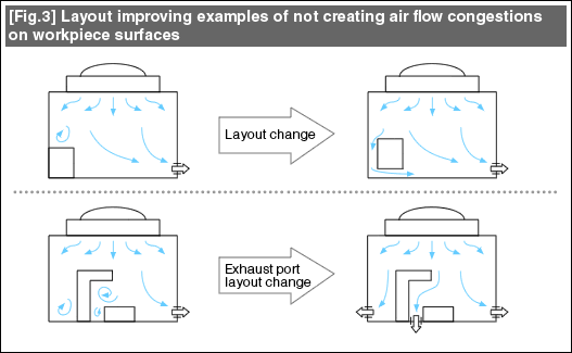

(3) Do not the contamination accumulate.
- Make fixture structure and layout less prone to contacting and accumulating contaminants.
- ■Example
- a) Fixtures that hold workpieces inverted or vertically.
- b) Do not create any congested air flow on workpiece surfaces.
- In order to obtain better cleaning effects, concentrate all the contamination generating mechanisms down flow.
