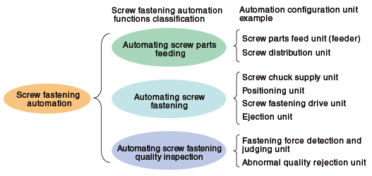

(1)Configuration for screw fastening automation
In order to automate the screw fastening, the system configuration including the before and after processes of screw fastening needs to be clarified. The screw fastening automation configuration can be classified as the following.
(2)Main troubles regarding screw fastening automation
When the screw fastening automation main troubles are functionally classified into 3 parts according to the outline above, it will be as follows.
