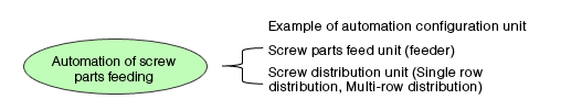

(1)Screw parts feed system configurations
Screw parts feed system configuration is as follows.

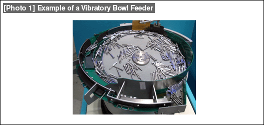

Screw parts feed unit - - - Device that automatically stores - Aligns - Separates the screws. See [Photo 1]
![[Photo 1] Example of a Vibratory Bowl Feeder [Photo 1] Example of a Vibratory Bowl Feeder](http://www.misumi-techcentral.com/tt/en/lca/images/131_02.gif)
| Screw distribution unit --- | A device that supplies the screws from the alignment unit to the chuck of the automated fastening device. It utilizes air pressure and etc. to transfer the screws through the distribution tube. |

1)Countermeasure examples on screw parts feed units
| (1) | In many cases, screw parts feeding misses (Causes: mixed contents, out of parts, hang ups due to burrs) can be effectively handled with error detections by photoelectric sensors and abnormality determination with a timer on the screw alignment feeder. | |
| (2) | Feeder internals and chutes where the components travel must be kept clean in order to maintain smooth sliding of the components. |
