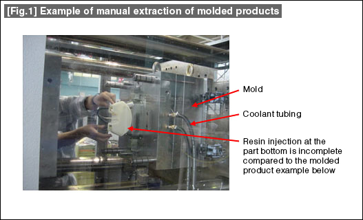

-[Fig.1] is an example of manual extraction of molded product, and it shows that the work cycle time is variable.

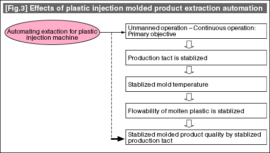

-Therefore, stablizing each of the work cycle time of the jnjection molding process leads to stablization of the mold temperature, and leads to molding quality stabilization by stablizing the flowability of the molten plastic ([Fig.2][Fig.3]).

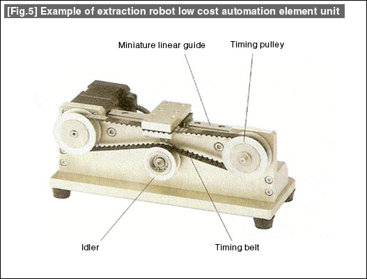

-For the automation of molded product extraction/low cost automation, a 2 axis robot and a gripper mechanism are used.
-When automating extraction using low cost automation, MISUMI single axis robot RSH and standard components app. Example: Belt Driven Shuttle Unit ([Fig.5]) can be the application reference.
