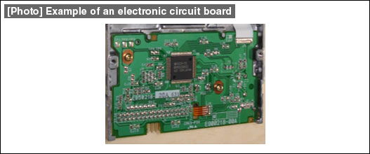

Products that require electronic controls, including consumer electrical appliances, all include some sort of electronic printed circuit boards ([Photo]).
