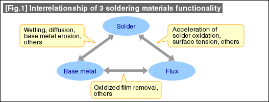

(1) Three elements of soldering related construction materials
As shown in [Fig.1], optimal soldering is obtained with a relationship of the three materials. Therefore, the soldering technology will need to establish an optimum system with these material characteristics.
