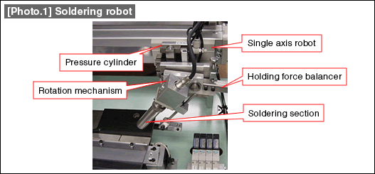

| - | Production technology needed for soldering robots will be explained with the soldering robot in [Photo 1]. |
| a) | Optimal selection of soldering iron tips against the object to be soldered■Explanation*Since heat conduction uniformity is required*Since uniform pressure application is required on sections to be soldered |
| b) | Solder supply method, position, amount■Explanation*Trained experts determine the size, amount, and application position of flux containing solder by soldering condition |
| c) | Solder iron tip pressure application method and soldering time■Explanation*Pressure bonding direction and load, also soldering time are determined based on the shape of workpiece to be soldered |
![[Photo 1] Soldering robot [Photo 1] Soldering robot](http://www.misumi-techcentral.com/tt/en/lca/images/159.gif)
