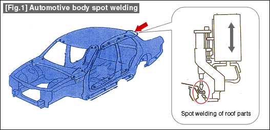

| - | A representative example of automated spot welding technology is the automotive production lines. |
| - | Automobile production line is composed of a collection of about 300 process steps, and about 4000 parts are assembled in around 50 seconds cycle time. |
| - | The representative technology that realizes the high production efficiency, high quality, weight reduction, body strength improvements, and safety is the spot welding technology. |
| - | The dedicated devices that perform high speed spot welding processes are the units with integrated high level technology with names such as Servo Guns and Air Guns. |

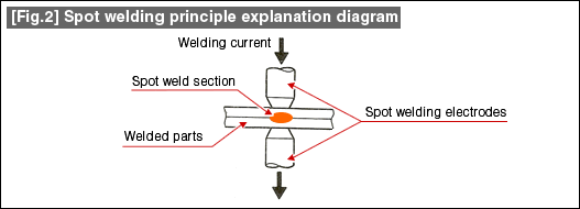

| - | Spot welding is a type of resistance welding that utilizes resistance heating by electrical conduction on the base materials, and jointing is formed in spots. |
