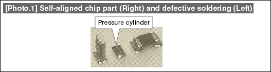

| - | Self positioning movement of the part that naturally occurs while the melting solder solidifies is called "Self-alignment effect". | ||
| - | On PCBs, preliminary solder spots are deposited where the parts are to be soldered. The self-alignment effect utilizes a phenomenon where the preliminary solder spots position the light weight parts into proper positions by melting solder's surface tension. | ||
| - | Adhesive flux is applied on the preliminary solder spots, and the parts are temporarily affixed on the preliminary solder spots by the adhesiveness of the flux. | ||
| - | The following production techniques are needed to gain the self-alignment effect.

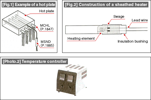

| - | In order to reduce the tact time while maintaining uniform heat conduction, mounting fixtures are preliminarily heated. | ||||||
| - | Aim of preliminarily heating
| - | Pre-heating table (MISUMI, hot plate: HTPL, [Fig.1]), Sheathed heater (MISUMI: MCHG, [Fig.2]), Temperature controller (MISUMI, Temperature controller: MTCS, [Photo 2]) can be utilized. | ||||||
| - | In order to make fixture side heat conduction uniform and accelerate, heat insulation material (EX.: Epoxy Glass Plates: EPXA) and heat transfer material (EX.: aluminum plate: A5052P) are used in designs. |
