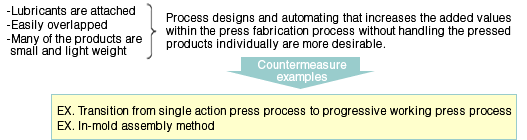

(2) Characteristics of press fabricated products
![]() | a) | Lubricants are attached |
![]() | b) | Easily overlapped |
![]() | c) | Many of the products are small and light weight |
![]() | d) | Characteristics of cut sections such as burrs |
Since the press fabricated products are typically of thin sheet metal, they are generally not subject to human hand handling immediately after the fabrication. High production efficiency is achieved through devising fabrication processes with little burrs, and easy to align methods.
(3) Points on Press Fabrication Automation
