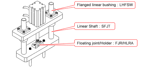

(1) Up/Down direction press unit with linear bushings
| - | This is a structure that can achieve stable sliding accuracies and a certain degree of rigidity at a low cost by adopting two linear bushings. |
| - | Adoption of flanged linear bushings increases the linear bushing mounting structure reliability. |
| - | By selecting the long type linear bushings with lubrication units lightens the maintenance workloads. |

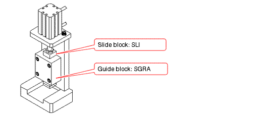

(2) A simplified press unit with Guide block and Slide block
Used for short stroke press fitting and swaging that does not require high speed continuous operation.
