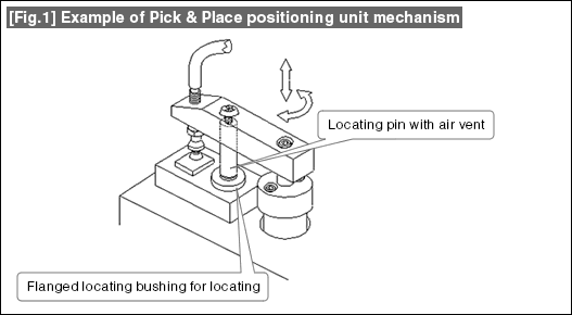

(2) Example of positioning unit construction
| - | In the case of in-mold assembly LCA, following three positioning units will be needed. 1) Workpiece positioning 2) Fore/Aft unit positioning 3) Up/Down unit positioning |
| - | These three positioning units are selected based on load weight, accuracy, and concerns for scratches, etc. |
(1) Basic type of positioning
| - | Anti-wear measures over long period of usage are important for the positioning system to prevent locating/positioning accuracy degradation. |
| - | The positioning basic is a set of locating bushings and locating pins with anti-wear measures applied. |
![[Fig.1] Example of Pick & Place positioning unit mechanism [Fig.1] Example of Pick & Place positioning unit mechanism](http://www.misumi-techcentral.com/tt/en/lca/images/167_01.gif)
(2) Workpiece positioning and Up/Down direction positioning example
■Explanation
| - | Select the locating pins (JPS) and locating bushings to make the spacing between the fixture plates as designed. |
| - | In this condition, the resin type locating pins (MJP) are to hold down the PCB at four corners. |
| - | The PCB is position located with 3 locating pins. |
| - | The additional work and inspection are applied through the opening located in the center of the top fixture plate. |
