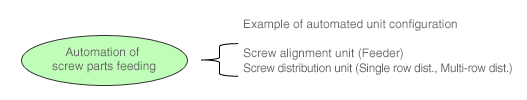

(1) Configuration of screw parts feeder
Screw parts feeder configuration is as follows.

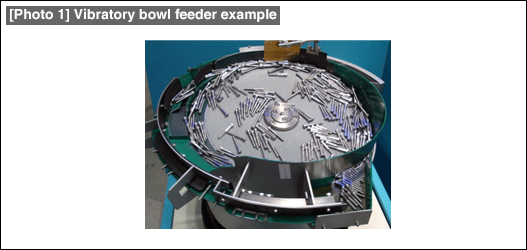

Screw alignment unit --- An automated device to store, align, separate screws. See [Photo 1]
![[Photo 1] Vibratory bowl feeder example [Photo 1] Vibratory bowl feeder example](http://www.misumi-techcentral.com/tt/en/lca/images/174_1.gif)
| Screw distribution unit --- | A device to distribute screws from the screw alignment unit to the screw chuck of the automated screw fastening device. Feed the screws through a distribution tube with air pressure, etc. |

| a) | In many cases of screw parts feeding errors (Causes: mixed parts, out of parts, hangups due to burrs) can be effectively detected and determined with photoelectric sensors and timers on the alignment feeder. | |
| b) | Internal tracts and chutes of the feeder need to be kept clean in order for the screws to slide smoothly. |
