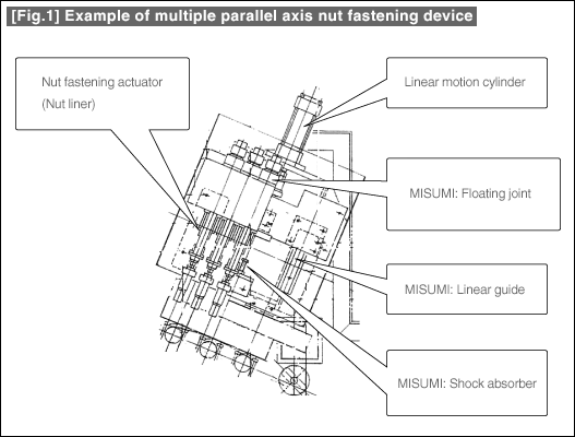

(2) Example of screw fastening unit
[Fig.1] is an example of an automated nut fastening device with 6 axes of fastening actuators (nut liners) mounted in parallel. Nuts are fastened after the 6 axis nut fastening actuator mounted on a linear guide is positioned by an air cylinder.
| Source: | [Automated mechanism illustrated collection] (Nikkan Kogyo Shinbun Co., edited |

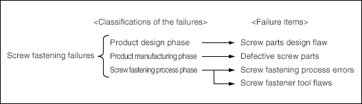

Screw fastening failures are classified, and the fastening device trouble countermeasures are explained below.
(1) Screw fastening failures and factors classified
Screw fastening failures can be classified as the following.
Below are the defect contents related to the screw fastening devices.
a) Screw fastening process failure
| ・ | Automated fastening unit control failure | |
| ・ | Screw fastening errors (Misalignment, diagonal fastening, etc.) | |
| ・ | Screw positioning error |
b) Screw faster tool flaws
| ・ | Worn or missing screw driver bits | |
| ・ | Worn screw chuck | |
| ・ | Inadequate maintenance on fastener tools |
