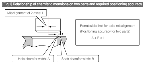

1. Relationship between part chamfering dimensions and required positioning accuracy
Required positioning accuracy of the automation device in relation to the chamfers of the two parts to be insertion assembled can be derived from [Fig.1]. The relational equation shown is required for the low cost automation designs.
![[Fig.1] Relationship of chamfer dimensions on two parts and required positioning accuracy [Fig.1] Relationship of chamfer dimensions on two parts and required positioning accuracy](http://www.misumi-techcentral.com/tt/en/lca/images/178_01.gif)

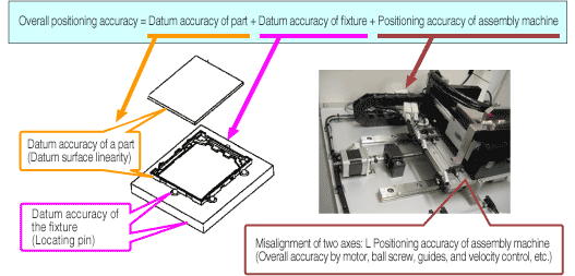

2. Overall positioning accuracy
・Please refer to the basics of positioning techniques explained over several volumes starting from the Technical tutorial Vol. 325.
・Overall accuracy of the positioning will be the accuracy of the total sum of various positioning accuracies.
・The overall accuracy of the multiple accuracies can be calculated as the square root of the sum of squares of each accuracy.
