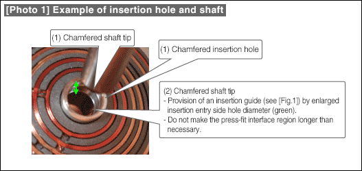

![[Photo 1] Example of insertion hole and shaft [Photo 1] Example of insertion hole and shaft](http://www.misumi-techcentral.com/tt/en/lca/images/177_1.gif)

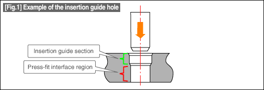

![[Fig.1] Example of the insertion guide hole [Fig.1] Example of the insertion guide hole](http://www.misumi-techcentral.com/tt/en/lca/images/177_2.gif)

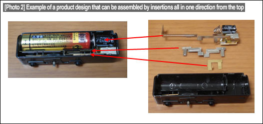

![[Photo 2] Example of a product design that can be assembled by insertions all in one direction from the top [Photo 2] Example of a product design that can be assembled by insertions all in one direction from the top](http://www.misumi-techcentral.com/tt/en/lca/images/177_3.jpg)

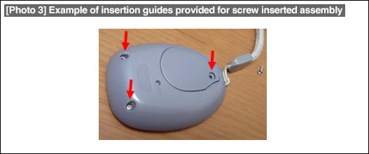

![[Photo 3] Example of insertion guides provided for screw inserted assembly [Photo 3] Example of insertion guides provided for screw inserted assembly](http://www.misumi-techcentral.com/tt/en/lca/images/177_4.jpg)
