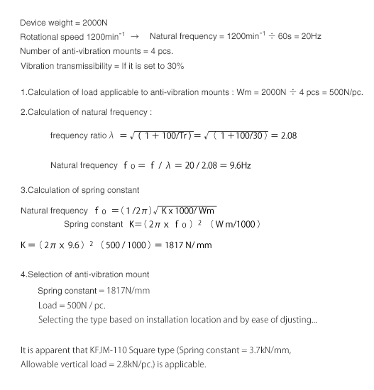

            Anti-vibration mount specifications are selected by the following steps.
Explanation on anti-vibration mount specification selection example: SI units
