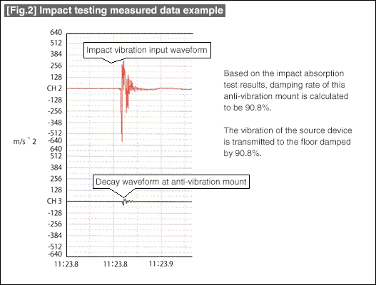

![[Fig.2] Impact testing measured data example [Fig.2] Impact testing measured data example](http://www.misumi-techcentral.com/tt/en/lca/images/183_2.gif)

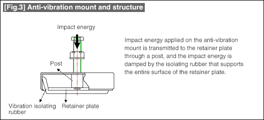

![[Fig.3] Anti-vibration mount and structure [Fig.3] Anti-vibration mount and structure](http://www.misumi-techcentral.com/tt/en/lca/images/183_3.gif)
