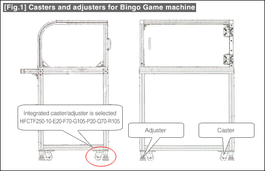

(2) In the case of Bingo Game machine
・Since this unit is used at shows etc., nylon wheeled small type with small turning resistance is selected.・HCFTF model casters are suitable for the frame unit.
・At installation location, adjust the bolt shaft so that the adjusters are slightly longer than the height of the casters (so the casters do not tough the ground), then make the horizontal adjustments at the equipment base plate with a bubble level, etc.
![[Fig.1] Casters and adjusters for Bingo Game machine [Fig.1] Casters and adjusters for Bingo Game machine](http://www.misumi-techcentral.com/tt/en/lca/images/188.gif)
