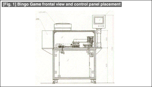

Display and control panel placements and supporting structure designs are important items in respect to machine controllability (ease of operation), safety, and the appearance.
Since the design of the display and control panel will need to be incorporated into main frame design, they can be considered as parts of the main frame design.

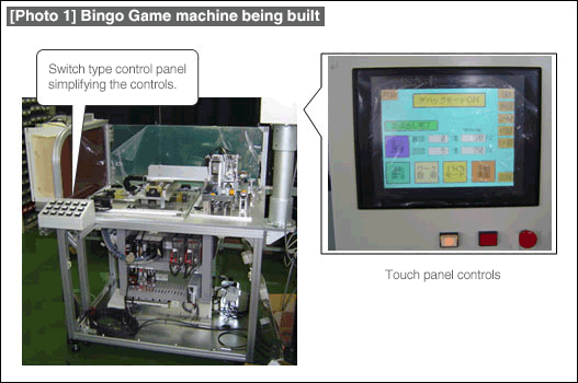

In case of dedicated automation machines, the number of control switches are reduced as much as possible and designs are dedicated in order to avoid the controls being complex.

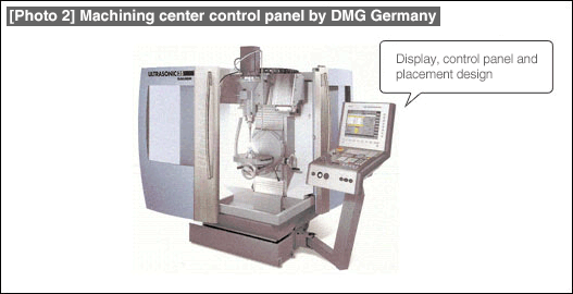

It will be helpful to look at the example of the machine tools for design trends in the control panels. The machine itself and the control panel form and layout are designed based on the standpoint of human engineering.
In addition, there are trends in reducing the keyboard operations and use touch sensing on the display for improved operability ([Photo 1][Photo 2]).
![[Photo 1] Bingo Game machine being built [Photo 1] Bingo Game machine being built](http://www.misumi-techcentral.com/tt/en/lca/images/189_01.gif)
![[Fig. 1] Bingo Game frontal view and control panel placement [Fig. 1] Bingo Game frontal view and control panel placement](http://www.misumi-techcentral.com/tt/en/lca/images/189_02.gif)
![[Photo 2] Machining center control panel by DMG Germany [Photo 2] Machining center control panel by DMG Germany](http://www.misumi-techcentral.com/tt/en/lca/images/189_03.gif)
