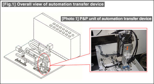

The weight of the assembled parts and actuator need to be reduced because the P&P unit parts are assembled to the XY table for high-speed drive control.For this reason, aluminum materials are frequently used for the manufactured parts parts, and reinforcement measures are incorporated into the structure design of the parts such as a long arm shape.It is also important to select a lightweight actuator.
![[Fig.1] Overall view of automation transfer device [Fig.1] Overall view of automation transfer device](http://www.misumi-techcentral.com/tt/en/lca/images/193_1.jpg)

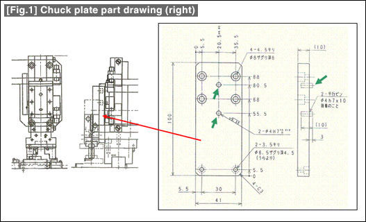

To move the chuck unit vertically, two locating pins are used for the part on which the chuck unit is mounted (chuck plate: see [Fig.2]). This part is assembled into the air slide guide with these two locating pins .
![[Fig.2] Chuck plate part drawing (right) [Fig.2] Chuck plate part drawing (right)](http://www.misumi-techcentral.com/tt/en/lca/images/193_2.jpg)
