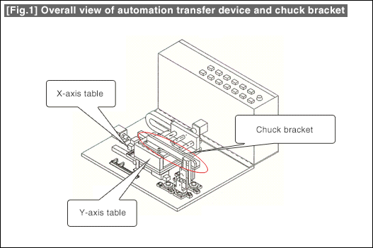

This section explains the chuck bracket (arm) in the part drawing of the P&P mechanism component.
![[Fig.1] Overall view of automation transfer device and chuck bracket [Fig.1] Overall view of automation transfer device and chuck bracket](http://www.misumi-techcentral.com/tt/en/lca/images/194_1.gif)
- The log arm attached to the XY table (see [Fig.1]) is composed of two plates for lighter weight and is assembled to the beam structure, which increases its rigidity.

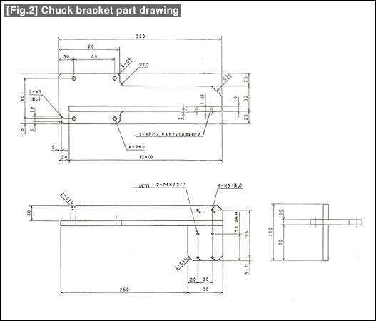

- Two plates are connected by welding. Add notes on the drawing for instructions on the manufacturing method (see [Fig.2]).
Example: Note 1) Welded construction with smooth surface finish
- The two plates are made of ferrous metal SS400 to allow welding.
- The drawing includes instructions on the surface treatment for rust-proofing and a better appearance.
Example: Kanigen
- Add notes for instructions on the manufacturing method for the chamfering finish on the outer circumference as well (see [Fig.2]).
Example: Note 2) C0.3 chamfering on each edge without remarks
![[Fig.2] Chuck bracket part drawing [Fig.2] Chuck bracket part drawing](http://www.misumi-techcentral.com/tt/en/lca/images/194_2.gif)
