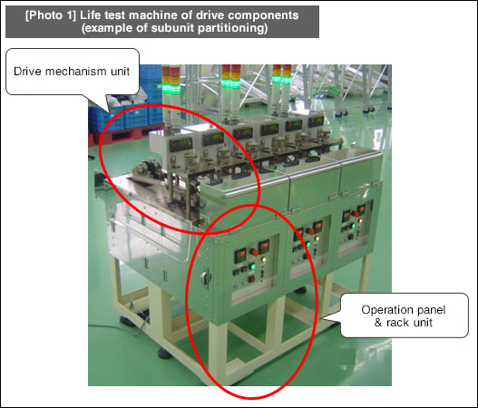

- In the case of a life test machine of drive components shown in the photo, detailed design drawings are prepared by dividing the machine components into the drive mechanism unit and the operation panel & rack unit.
