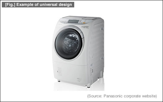

- Universal design refers to the concept of designing products and the built environment to be usable to the greatest extent possible by everyone without special alterations or unconventional design work.

- The seven principles of universal design can be applied to the principles of designing production facility and tools used in production lines. Especially, these principles will be the important hints on designing devices designated for older adults.
