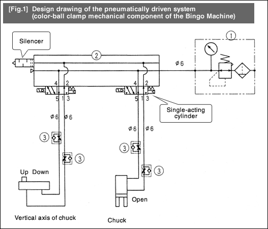

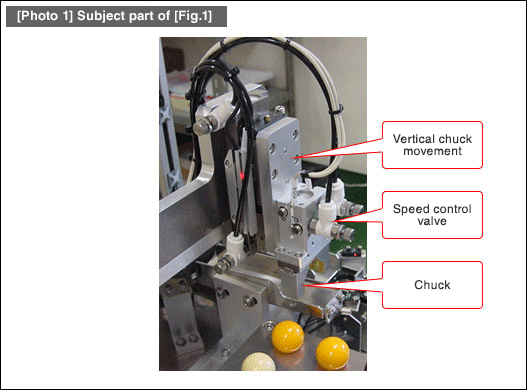

- [Fig.1] is an example of a design drawing on a pneumatically driven system installed in the color-ball clamp mechanical component of the Bingo Machine. The part number (1) is a filter regulator, (2) is an accumulator, and (3) is a speed control valve. The other components include a single-acting cylinder and a silencer.
- Since this design drawing includes parts specifications, the drawing also illustrates components, specifications, piping layout, open/close status of the chuck parts along with the positional relationship of the vertical chuck axis.
