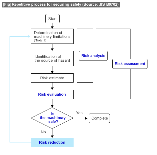

(2) Repetitive process for securing safety
A series of processes including risk analysis and assessment as well as risk reduction activities are repeated in the action process shown in the following figure. The knowledge on safety during the machinery design/production stage can be accumulated as a result.
![[Fig] Repetitive process for securing safety (Source: JIS B9702) [Fig] Repetitive process for securing safety (Source: JIS B9702)](/tt/en/lca/480.gif)
*Note 1 --- Consider the operator's characteristics such as age, dominant hand, limit on physical performance, knowledge level (beginner or expert), etc.
