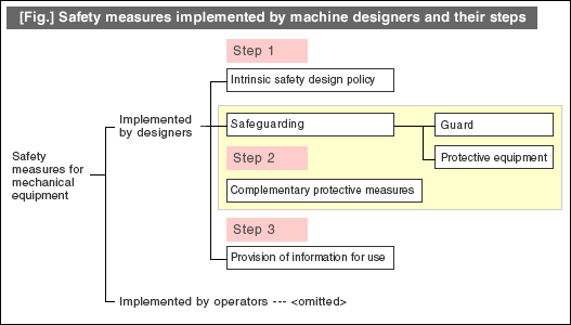

(2) Safety measures for non-intrinsically safe device
You may need to implement additional safety measures for purchased equipment or when it is difficult to install a built-in safety device into the equipment during the initial design stage. The best way for such cases would be to implement safety measures in a step-by-step manner as shown in the below figure.
![[Fig.] Safety measures implemented by machine designers and their steps [Fig.] Safety measures implemented by machine designers and their steps](http://www.misumi-techcentral.com/tt/en/lca/479.gif)
