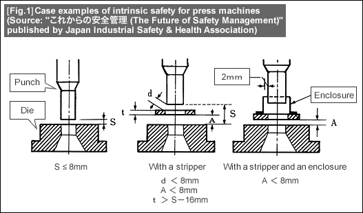

- Examples of intrinsic safety design
a) Installation of a safety enclosure for the press die --- Install an enclosure around the die so that the operator's hands or fingers will not contact the processing points.
b) Adopting a structurally safe design --- Keep the clearance between the upper and lower dies or between strippers for the upper and lower dies to be 8 mm or less to prevent the operator's hands or fingers from being placed in the gap. (See [Fig.1])
c) Automatic press design --- Eliminate tasks requiring hand insertion by adopting an automatic system of supplying materials and/or discharging processed goods.
d) Safety press design --- Install a safety device with optical sensor or embed the safety design into the equipment by installing a two-hand control button.
