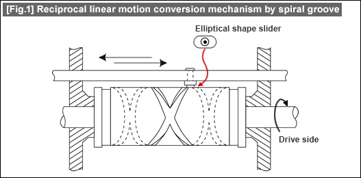

First, we will look at a mechanism converting rotary motion into linear motion. Most of the mechanisms converting rotary motion into linear motion can also be used as a mechanism for converting linear motion into rotary motion by reversing the mechanisms. Since human motion is more compatible with the rotary motion task than the linear motion task, conversion from rotary into linear motion seems to be more common for simple fixtures.
(1) Mechanism converting rotary motion into linear motion
(1) Reciprocating linear motion by spiral groove (See [Fig.1])
By cutting a continuous spiral groove on the cam surface and placing an elliptical shape slider that slides along the spiral groove, the elliptical shape slider performs reciprocal linear motion according to the rotation of the cylindrical cam.
