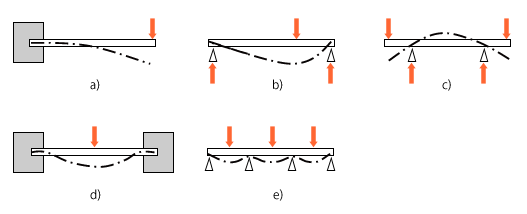

(1)Types of "beams"
Beams are generally available in the following five types:
| a)Cantilever --- | A beam structure anchored at only one end. The fixed side is called fixed end and the opposite is called free end. |
| b)Simply supported beam --- | A beam structure where both ends of the beam are simply supported. |
| c)Overhanging beam --- | A beam structure where loads are applied to the outside of the fulcrum. |
| d)Fixed beam --- | A beam structure where both ends of the beam are fixedly supported. |
| e)Continuous beam --- | A beam structure that is supported by three or more fulcrums. |

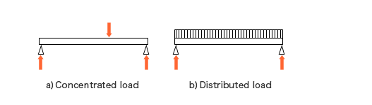

(2)Types and expression of loads applied to the beam
- The case a) is a structure model that the mechanism is installed at the loaded area. The case b) is a model to adopt if you need to consider the effect of the weight of a beam itself.
