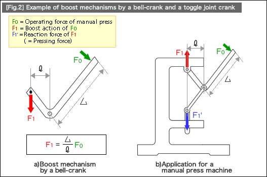

A bell-crank can be described as a bent version of the seesaw-type boost mechanism. The principle of the boost mechanism is the same, but because of the bent shape of the crank, the arm length is designed to be perpendicular to the direction of force applied, resulting in a different boosting effect ([Fig.2] - a)). A bell-crank is shaped the same as a nail puller used for carpentry work.
If you combine a bell-crank with a toggle joint crank, you will be able to create a simple manual pressing machine shown in [Fig.2] - b). In this mechanism, the force applied to the bell-crank handle (F0) is amplified by the bell-crank's boost mechanism in accordance with the arm length ratio and transformed into force (F1). The cabinet of the simple press machine supports this force. The toggle joint then diverts its reaction force toward the opposite direction, creating the pressing force (F1').
Application examples
| 1. | Manual press machine | |
| 2. | Manual swaging machine | |
| 3. | Manual crimping machine, thermocompression bonding machine | |
| 4. | Flatness correction |
