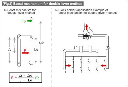

In this volume, we will look at a case example of a "double-lever" created by connecting levers utilized in the boost mechanism. The double-lever method not only delivers the boost action in the simple seesaw-type principle but also allows the force direction to be changed.
[Fig.1] - a) illustrates the boost mechanism for the double-lever method. The amplified force (F) is determined by the relationship between the arm length ratio and the equilibrium of forces.
[Fig.1] - b) is a simple fixture (tool) called a "block holder", utilizing the double-lever method. This mechanism is often adopted for tools designed to carry heavy square-shaped items like bricks and blocks.
![[Fig.1] Boost mechanism for double-lever method [Fig.1] Boost mechanism for double-lever method](/tt/en/lca/095.gif)
Although the seesaw-type boost allows the operation of heavy objects with less of force, it is important to remember that the principle of the workload <Workload (Kgm) = Force (Kg) × Movement (m)> always applies. Less amount of force means more movement. If manpower is required for larger strokes or reducing a particular task cycle (such as moving or bending) does not make the entire task inefficient, it is possible to amplify the forces or movement based on this workload principle.
