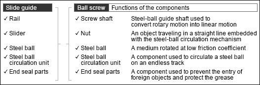

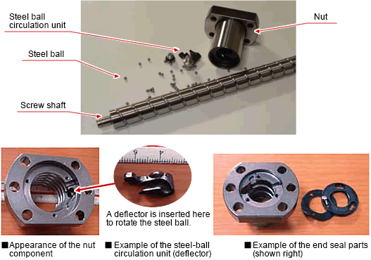

A standard ball screw is comprised of the following components:
Compared to slide guides, this structure is probably easier to understand. A slide guide is a unit that produces linear motion along the rail. On the other hand, a ball screw is a unit where screw shaft rotation causes a nut to travel in a straight line.
