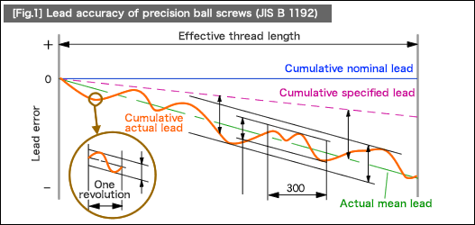

The major factor in determining ball screw accuracy is called "lead accuracy". (See the Note* for details.) The two evaluation items of "lead accuracy" and "appearance" are called "ball screw grades" and used for the classification of quality.
Notes*

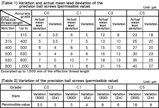

| ∗ | Lead accuracy: [Fig.1] defines the deviation and variation for the effective travel distance of a nut or the actual mean lead of the effective thread length of a screw shaft, variation for any 300 mm interval in the effective thread length of a screw shaft, and variation for one revolution within the effective thread length. The permissible values are listed in [Table 1] and [Table 2]. |

![[Fig.1] Lead accuracy of precision ball screws (JIS B 1192) [Fig.1] Lead accuracy of precision ball screws (JIS B 1192)](http://www.misumi-techcentral.com/tt/en/lca/337_1.gif)
![[Table 1] Variation and actual mean lead deviation of the precision ball screws (permissible value),[Table 2] Variation of the precision ball screws (permissible value) [Table 1] Variation and actual mean lead deviation of the precision ball screws (permissible value),[Table 2] Variation of the precision ball screws (permissible value)](http://www.misumi-techcentral.com/tt/en/lca/337_2.gif)
