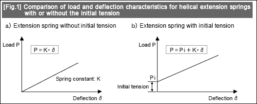

(1) Helical extension springs with initial tension
- Initial tension, which is a force holding the coils against each other, can be put into helical extension springs even under a no-load condition.
- The initial tension is created by twisting the wire in the direction of the coils in contact with one another during the spring winding process.
- Cold-formed and solid-coiled springs are wound with some tension. In general, springs that are purposely designed to have initial tension are referred to as springs with initial tension.
- The load and deflection characteristics of springs with and without the initial tension are shown in [Fig.1].
- [Formula A] represents the relationship between loads and deflection of an extension spring shown in [Fig.1]. [Formula B] is a relational expression between loads and deflection of an extension spring with the initial tension.
[Formula A]
Load P (N) = Spring constant k (N/mm) × Deflection δ (mm)[Formula B]
Load P (N) = Initial tension Pi (N) + Spring constant k (N/mm) × Deflection δ (mm) - Initial tension Pi will be calculated in the following formula:
