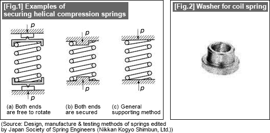

(1) How to secure helical compression springs
In considerations of the degree of freedom of the secured spring, avoiding buckling, and prevention of load-point displacement, the methods shown in [Fig.1] are adopted for securing both ends of helical compression springs. As for the tips, use a Coil Spring Washer (SPGCC, for example) by MISUMI for its ease of production if you use the securing method shown in (b). Otherwise, prepare a guide hole on both ends and place the spring into it.
![[Fig.1] Examples of securing helical compression springs. (Source: Design, manufacture & testing methods of springs edited by Japan Society of Spring Engineers (Nikkan Kogyo Shimbun, Ltd.)), [Fig.2] Washer for coil spring](/tt/en/lca/230_1.gif)

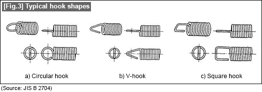

(2) How to secure helical extension springs
Hooks on both ends of helical extension springs are available in various shapes. a) is the most standard shape. See the characteristics of b) and c) in the following table.
![[Fig.3] Typical hook shapes (Source: JIS B 2704)](/tt/en/lca/230_2.gif)
![[Photo 1] Helical extension springs and posts on both ends](/tt/en/lca/230_3.jpg)
a) For circular hooks, adopting posts for extension springs by MISUMI (e.g. ASPO, ASPL) makes the adjustment easier. (See [Photo 1].)
