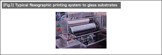

-In the case of glass substrates, silicon wafers, and other thin sheet-like works, work-holding based on the vacuum chucking is often adopted in the equipment in the process of printing on the front side of a substrate (Figure 1).
-This is due to the difficulty in adopting mechanical clamping for the thin sheet-like works and the ease of attaining the environment (ease of control of temperature, pressure, airflow, and other factors) necessary for assuring consistent quality in the printing process. This allows simplified mechanical structure by nature, thus providing advantages of increased cost effectiveness, including lower system prices and shorter tact time.

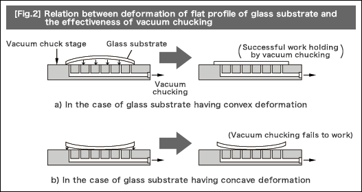

-Figure 2 illustrates how the effectiveness of vacuum chucking depends on the flat condition of works (glass substrates) being chucked.
-In the case of vacuum chucking method, those works that have the flat profile with the outer region contacting the stage (convexly deformed) are vacuum-chucked more effectively (Figure 2-a)).
-In contrast, those works that have a flat profile with the outer region warped upward (concavely deformed) are less effectively vacuum-chucked (Figure 2-b)).

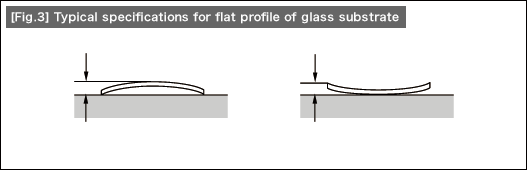

-To eliminate the susceptibility to different flat profiles of works being chucked, two (2)solutions are available as listed below.
1.To adopt the specifications for the initial flat profile of works being chucked. (Figure 3) → To eliminate loading of any concave-deformed works exceeding the specifications.
2.To incorporate the mechanical structure designed to press every work to be chucked against the stage from above in advance of vacuum chucking.(Investment to be required)
