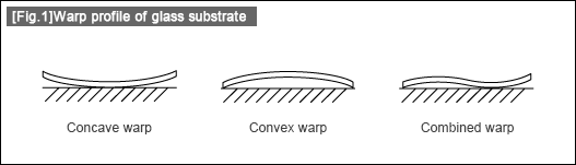

・Glass substrates vary in warp according to the manufacturing lot.This is due to the difference in residual stress produced on the front and back sides in the manufacturing process of glass substrates. The warp profile may be grouped into concave warp, convex warp, and combined warp (Fig.1).

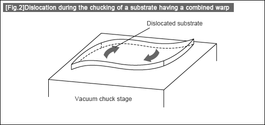

・Regarding the glass substrate having combined warp, the glass substrates may be dislocated during the vacuum chucking.This is attributable to the vacuum chucking force acting unevenly because of uneven and deviated gap between the glass substrate and the processing stage (Fig.2).

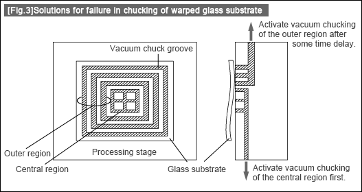

・To succeed in effective vacuum chucking of the central region of a glass substrate first then vacuum-chucking of the outer region after some time delay, thereby ensuring stable chucking of the glass substrate.
・Control of position and timing of the vacuum chucking may be attained as follows: For the former or control of vacuum chucking position, design the paths of hole independently for the central region and the outer region (Fig.3). For the latter or control of the timing of chucking, control the timing of the solenoid valve in the vacuum chucking control circuit.
