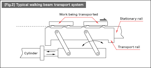

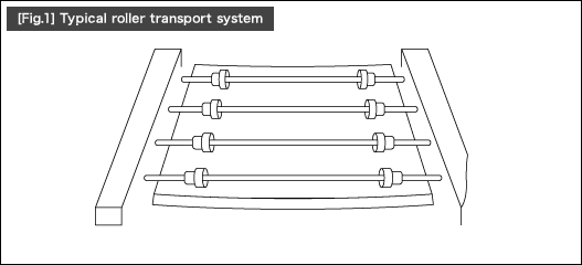

In a total of six installments, explanation is provided about designing of mechanical structure for transfer of thin sheets to respond to the trend for weight reduction. For transfer of glass substrates, two (2) major systems are available, roller transport (Figure 1) and walking beam transport (Figure 2). This session focuses on the roller transport system.

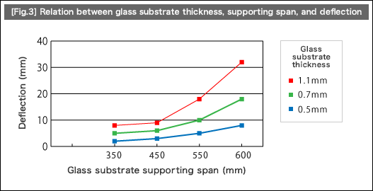

-Regarding glass substrates, as the thickness becomes smaller, the deflection due to own weight abruptly increases as shown in Figure 3.
-As can be seen from the Figure, for glass substrates of 0.7 mm or less in thickness, a two-point holding system will be impractical for transport when the substrate holding span is larger than 450 mm.
-In addition, the glass substrates will be likely to become broken or fractured due to trouble during transport.

| 2. | Each substrate is transported by the frictional force produced depending on its own weight acting on the several feed rollers supporting the substrate. In practice, however, the frictional force can vary greatly at the contact points between the substrate and individual rollers due to any deformed substrate. If the frictional force on the feed rollers at the respective ends are not equal to each other, the substrate will be transferred curvedly. | |
