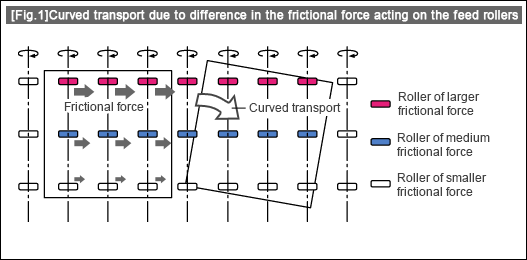

2) Stabilized transfer of glass substrates
・ To guide the loads being transported to move straight on the transfer line, the direction of action of frictional force for transport must be made straight.
・ There is no correlation between increasing the number of roller support points for substrates and making the direction of action of frictional force for transport straight.
・ If the frictional force acting on the feed rollers becomes unbalanced, the loads being transported fail to move straight but their transport direction changes, resulting in transport problems.
・ Fig.1 illustrates possible behavior of substrates being transported when the frictional force acting on the feed rollers differs between roller positions, or in this Figure, the frictional force is largest at the leftmost position followed by the middle and rightmost positions.Possible reasons why the frictional force becomes different include 1. bent shaft connecting the feed rollers, 2. partially or unevenly worn feed rollers, and 3. inclined horizontal reference for the transfer machines.
・ Therefore, in addition to the adoption of the 3 rows independent feed roller arrangement, proper provisions must be made to equalize the frictional force on the feed rollers supporting the substrates.
