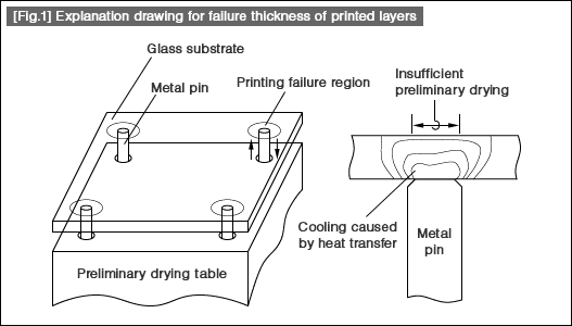

-The printing process to glass substrates involves lifting up operation of the glass substrates by metal pins for handling on the tables for both printing machine and preliminary drying.
-When glass substrates are lifted up by metal pins on the preliminary drying table, failure thickness of printed layers occurs easily around the metal pins (Fig.1).
-This failure results from incomplete preliminary drying after printing, which is explained by the fact that due to the contact of metal pins with glass substrates, the contact area of heated glass substrates with metal pins becomes locally cooled, thereby leading to lowered temperature.
-Thus, the smaller the thickness of glass substrates and silicon substrates, the more severe failure thickness of printed layer occurs around the contact area with metal pins.

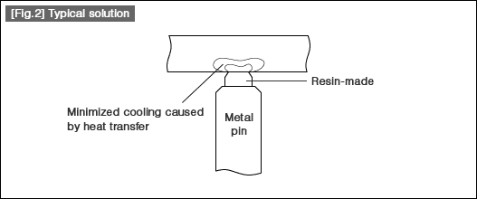

(3)Solutions to possible failure thickness of printed layers
-Due to the high thermal conductivity feature, metallic parts incorporate more thermal energy from glass substrates.
-In order to minimize the incorporation of thermal energy from metal pins, such solutions are recommended that adopt the design to apply a material of lower thermal conductivity for the tips of metal pins and/or change the material of the tips of metal pins (Fig.2).
