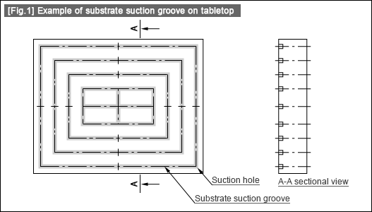

・To work with a thin glass substrate, various processing will be performed on this substrate by attaching the substrate onto a work table using vacuum suction.In this case, the glass substrate should be positioned against the table by aligning its outer periphery with the reference plane of the table. While keeping this alignment, you will place the glass substrate onto the tabletop and keep the substrate in place using vacuum suction.
・In order for this vacuum suction to work with glass substrates of various sizes, the tabletop has various shapes of vacuum suction grooves. (Fig.1)

・If the vacuum suction groove (width) is too broad compared to the thickness of the glass substrate that is affecting the rigidity, the groove deforms locally due to the vacuum suction force.
・To prevent these failures, the width of this vacuum suction groove should be minimized so that the glass substrate will not deform by the vacuum suction force. (Fig.3)
・The problems can be eradicated by replacing the tabletop materials with ceramics having the porous structure, rather than making changes to the vacuum groove mechanism.
